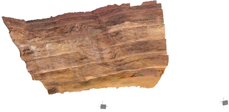

In this first example, the objective was to capture a section of pit wall for geotechnical analysis. The project area was 390 m × 190 m. A Canon EOS 5D with 100 mm lens gave a 4 cm ground pixel size at a range of 450 m, which was the distance from the wall to the crest on the opposite side of the pit — a good vantage point because it gave a clear view of the entire surface.
The camera stations were 290 m apart, giving a base:distance ratio of 1:1.6. This is slightly further apart than we normally recommend but since the wall is relatively flat it didn’t cause any problems with occlusion or image matching.
Six images were captured at each station — two rows of three images each. It took less than 30 seconds to capture the six images, and about a minute to set up the tripod with the camera and panoramic camera mount on it. It took about 8 minutes to walk from one camera station to the other. Total time to capture the images was therefore about 20 minutes, largely due to the time spent walking to the stations. Camera stations were not surveyed.

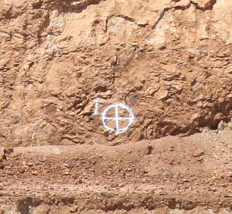

Six control points were painted on the wall, surrounding the area of interest. (These are visible as red dots in the image above.) This is the ideal configuration because it means we’re not extrapolating beyond the controlled area, which tends to magnify any errors in the survey data, although the precise locations are not critical and can easily be varied to take local circumstances into account (in particular, safe access). The control points themselves were simple crosses with a circle around them and their ID painted on the wall next to them to make it easier to identify them later in the images:
For surveying purposes, a semi-permanent network of control points like these would normally be established, allowing future field exercises to simply include images of existing control points within the fan of images. Prisms being used for monitoring can also be used for control. For geotechnical applications, where close inspection of the rock surface is normally required to obtain additional information about the rock mass that is not readily available from photographs, painting of the control points can be combined with the close inspection.
In this particular case the control points were surveyed using a reflectorless total station from the same crest the photographs were captured from. GPS measurement at the time the control point is painted is the other common technique for surveying.

All up, less than 10 minutes between loading the images onto a PC and having the DTMs ready for mapping. The control point RMS’ in this case were 0.041 m in X, 0.022 m in Y, and 0.029 m in Z, for an overall 3D point accuracy of 0.055 m.
According to the calculations given in Part 2, the expected accuracy for this configuration is 20 mm in plan (corresponding to X and Z in this project) and 29 mm in depth (corresponding to Y in this project). Why is it worse?
There are actually two additional, independent sources of error in this case. The first is apparent from looking at the control points themselves — the white lines painted on the rock are 80 mm wide. When the surveyor picked up the location of the centre of the cross using the total station, there is no guarantee that he picked the same point on the ground as we did when digitising that point in the image. One advantage of using circular targets is that the software can find the centre of the target very accurately and, if a prism or other mark is painted right in the centre of the circle, the surveyor can pick up the centre very accurately as well.

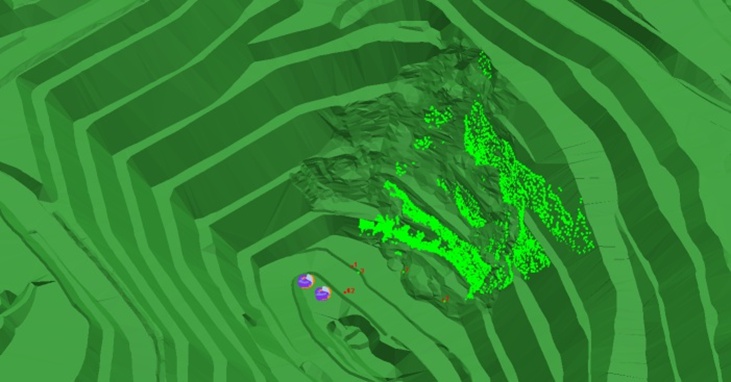

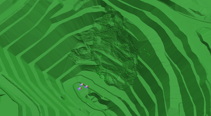

In this second example, the objective was to survey a failure. The project area was 200 m × 200 m. A Canon EOS 5D with 50 mm lens gave a 3 cm ground pixel size at a range of 180 m.
The camera stations were 25 m apart, giving a base:distance ratio of 1:7.
Two images were captured at one station and three at the other. Coupled with the short distance between stations, this means that the image capturing itself was extremely quick. Camera stations were not surveyed, but a total of 10 interesting points on the pit wall and nearby (a delineator, the top of a sign, and distinctive rocks) were surveyed with a reflectorless total station. By far the majority of the time was in setting up the total station itself, which was done in parallel to the image capturing.

Control point residuals were 0.015 m in X, 0.005 m in Y, and 0.006 m in Z and ranged from 25 m away to 200 m away. Expected planimetric accuracies range from 0.002–0.017 m and depth accuracies from 0.015–0.120 m so accuracies were actually better than expected, especially since many of the control points were the centres of quite large rocks.

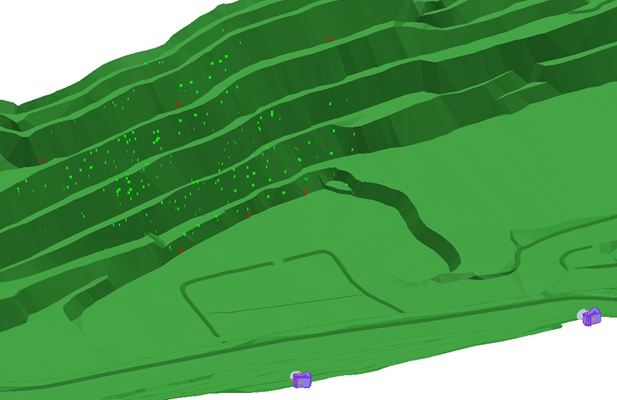

Another option is to substitute surveyed camera stations for control points. Since we need at least three surveyed locations (not in a straight line) to georeference a project, to eliminate control points entirely requires three camera stations (not in a straight line) to be used.
In this case, the Canon 5D was equipped with a 28 mm lens and three images were captured in a triangular configuration about 25 m apart from each other. The camera was handheld and the GPS receiver was simply placed above the camera to take a reading at the same time the images were captured. The total time was less than 2 minutes.
If more accuracy is required, ADAM’s camera mount is equipped with an optional tribrach adapter that allows it to be mounted directly onto a standard set of survey legs. This makes it simple to survey camera stations — simply remove the camera and place the GPS receiver immediately on top.
Since the controlled area is relatively small, any errors in the surveyed locations are going to be extrapolated in proportion to the distance to the area of interest. To reduce this problem, camera stations can be placed further apart, and even lenses changed if required to keep the ground pixel size comparable between different locations.

It’s a little difficult to talk about accuracy in this case because only three surveyed camera stations were used, giving very little redundancy and therefore little opportunity to glean something meaningful from the residuals. Adding a fourth camera station and/or one or more control points in the field of view would help.
