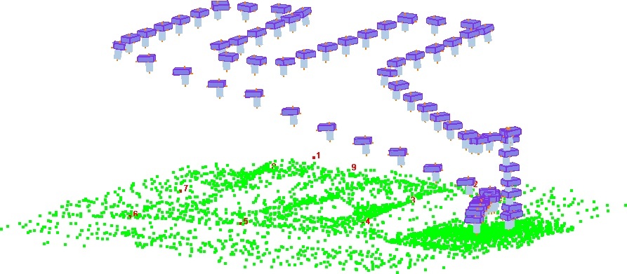

The first issue is the camera’s orientation. For aerial projects we normally need to do multiple strips of parallel images so we can cover a large area:
Strips

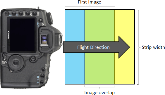

Landscape
Figure 3. Landscape mode
(Blue represents the first image, yellow the second, and green the area of overlap.)
The model area is 72 m × 180 m, so to capture an area of 1,000 m × 1,000 m with a 20% overlap between strips we would need a total of 147 images arranged in seven strips of 21 images per strip. The base:height ratio is 1:2.50, and with an image accuracy of 0.5 pixels the expected planimetric accuracy would be 1.6 cm and the expected height accuracy would be 4.0 cm.
Now suppose we rotated the camera 90 degrees, so that the long axis of the camera was in the flight direction (and the camera therefore sees the ground moving sideways with respect to it):

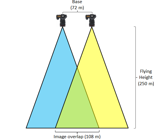

Longer focal length lenses necessarily require camera stations to be closer together at the same flying height in order for the image overlap to be the same because the image footprint on the ground is smaller. If the flying height is increased to the point where the image footprint is the same as the shorter focal length lens, the camera separation will also be the same. So, with the same camera and image overlap as before but with a 50 mm lens, we get the following geometry:
50 mm Lens Geometry
Figure 6. 50 mm Lens Geometry
Now we’re flying at 250 m in order to get the same ground coverage and same overlap, but our base:height ratio is 72:250 = 1:3.47, which means our height accuracy will be 3.47 times worse than our planimetric accuracy.
In both of the examples above, the planimetric accuracy will be the same because the ground pixel size is the same, but the height accuracy will be twice as bad in the second case. Since height accuracy is normally what is specified, it makes sense to prefer the shorter focal length lens. It’s also more resilient to bumpiness during flight because a small change in angle of the camera will have less impact on the overlap than it would with a longer focal length lens.
